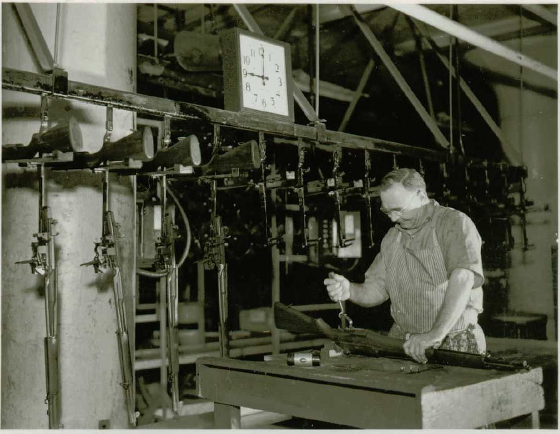

    I love seeing vintage pics of our beloved M1's being born,I'd bet they had the same tool for M14's?!!
    Works for both the M1 and M14>>>
    For sale:M1 Garand Trigger Guard "Breaker" Removal Tool. An AmmoGarand Custom madein the USA Garand Tool. MUST HAVE for any Garand Owner! Tool saves wear and tear on you and your rifle trigger guard by allowing you to easily release both milled and stamped trigger guards to allow removal of the trigger group assembly. | eBay!

    Here is a good picture from Springfield Armory ,notice the nice trigger guard unlatching tool being used.
