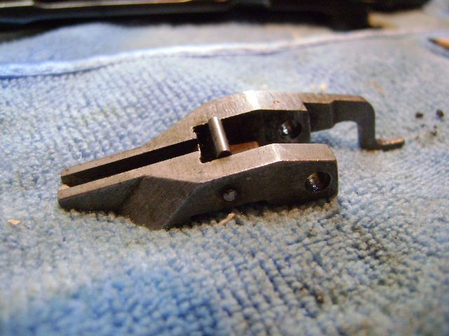

    Your rifle is not early enough to use a op rod catch with a "0" on accelerator. It would use a unmarked no lip op rod catch
    Type 1 would be correct,knurled windage, checkered elevation. Should have a SA/GHS small ordance wheel stock
      May or June 1942 Springfield would have a Type 1 lock bar (same thread as the flush nut also with short pinion) . I have a Springfield s/n 613217 with a S-A 6-42 dated barrel. The bolt is D28287-12 SA RE5B with the hole through the right locking lug. Op rod is uncut rev 3. rear sight: cover is coded, short pinion, windage knob knurled elevation knob checkered. Follower #8, bullet guide milled, op rod catch without finish no lip on accelerator. Follower arm late, follower rod short fork. Stock short channel faint SA GHS, rear hand guard clip milled with groove, op rod cut. Click image for larger version

        lists the Op Rod Catch as being 0 marked.
        Scott
          early Springfield operating rod catch with 0 stamp used up into early four digit serial range (example Canfield's s/n 2126)
            My SA 200442 has one if them. The datasheets list the 0 marked op rod catch much later than that.
            Scott
              Do yourself a favor and do not use that web site, it is full of inaccuracy's. You are better off asking here and listening to what you are told, we will not give you inaccurate information
                Ok cheers mate😁Do you have a pic of the op rod catch I need to find?
                Cheers!
                Scott
                    Spot on mate thank you!
                    Scott
                      On the accelerator on the catch there are two types, accelerator with and without lip. I "think" they changed over to accelerator with lip mid 1942. That being said either would probably be correct for you rifle as they would have run parts until old type was used up
                      Someone else may come along with their opinion
                        Anyone have a pic of an OP rod catch with accelerator with lip vs without?
                        Scott
                          A op rod catch "with lip" will have a ridge or lip on the top on one end of the accelerator. Without lip will be smooth, no lip
                            Thanks Orlando!
                            Scott
