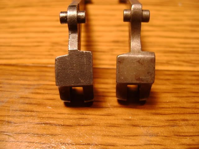

    The Flat Back Follower Arm on the left not real common but not rare, Double Faced Follower Arm on the right. These you dont see all that often but do come around occasionally. They were used for a short time in the 30,000 into 40,000 serial range
    Very nice, Bill. Thanks for posting these photos!!
