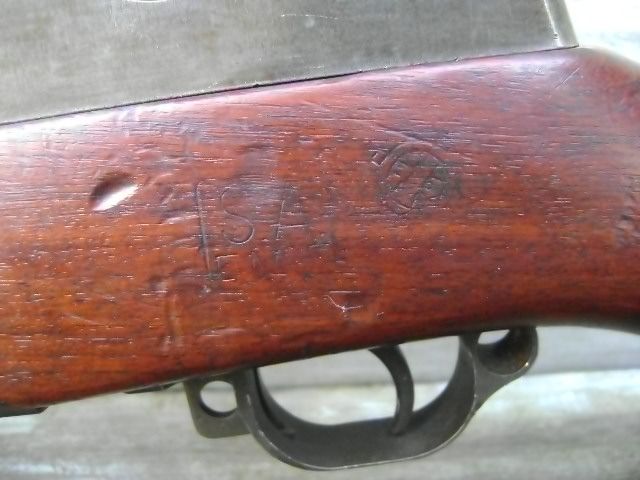

    I'm finally making what I call a "serious attempt" at a restoration, and decided to try and work on a barreled receiver that I got from a friend. It came from the CMP as a service grade, but many of the parts were stripped for one of his projects.
    I'd really like some feedback as to whether or not I'm on the right track with this project, so any comments and/or suggestions on how to improve the project would be greatly appreciated. Here are a few photos showing where I am with it right now.
    Thanks in advance!

      Any thoughts on the selection of wood for this restoration?

        The restoration has now been completed, and I'll try and snap some pix of the whole rifle sitting in the sunlight tomorrow. I tried to achieve an overall color match, but some parts are a different shade than others, which I know that original rifles had that as well so I'm not too concerned.
        Any thoughts? Is it looking good or not really??
          Looks good. Everything seems to flow well. Original rifles don't have perfect match finishes. You have a good flow in the parts and wear. Nice job.
            Looks good Brian. Didnt they have rear sights in 1943???

            As mentioned above it flows nicely. Can't tell because of my old eyes, but the stock ferrule looks like it may have a dimple staked convex screw which might indicate WRA manufacturer. Is the hole off center, does it have a T or of character inside the left wing and the half circle or C as people reference?

              Hi Curt,
              Thank you for your comment!
              The stock ferrule does have a dimple-staked convex screw, and it's just a hair off center. It's of "stamped" manufacture and has a large hole, which is centered. There's no "C" or "O" inside and there are no other marks on it.
              Thanks again for taking the time to comment.

                  Thanks guys........here she is. All photos are in unfiltered sunlight. I was a bit rushed, so I apologize for the blurriness of some of them.
                  Please be brutally honest with me. I really want to "get into" restorations, but I need guidance.

                      Looks pretty 'been there, done that' to me.
                      Nice job.
                        Nicely Done Brian
