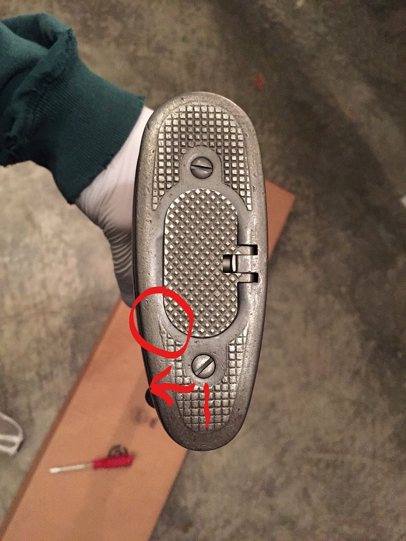

Hello everyone! I just purchased this Winchester M1 garand. This is serial number 1,298,xxx which dates to March 1943. This particular rifle is all correct and I believe all original. All three pieces of wood appear to be original and unsanded. Cartouches are excellent, no rebuild marks or import marks. Two questions I have of which one will be in another posting. I will start off with the buttplate. The finish matches excellent with the wood and the rest of the rifle. This is one of which is not marked 2S. I believe I understand Winchester used some non-2S buttplates if I'm not mistaken him. My question is could this be one of those and what should I look for if this is a non-2S buttplate?
Winchester buttplate?

#1 - Notice how the lower checkering comes up to a point (red circle). On all other plates the checkering won't go up quite as high and will end flat instead of a point.
#2 - Notice how the lower screw hole looks to be off-center to the left? The hole is actually centered, the stamped checkering is what is off-centered.
#3 - The border of the checkering will be nice and crisp on a plate without a lot of wear.
Your buttplate is SA. I have a couple of WRA plates if you would like to swap...just let me know.

I do already know that these three items which you pointed out are the same very characteristics of a 2S marked buttplate. Did the unmarked buttplates for Winchester also carry these three same characteristics? Just a question! Does anyone know for sure? There is no information in any books on this topic that I know of. Thanks!
