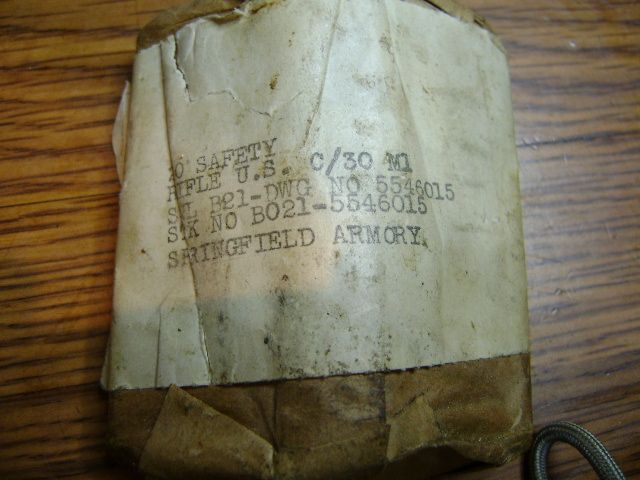

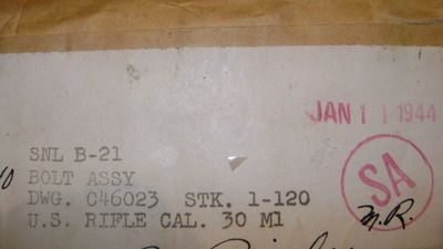

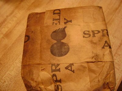

You have to be careful buying parts on E-Bay. People are selling used refinished parts as NOS. Nothing wrong with the parts but you should not pay NOS prices for used parts
Just because parts are in wrap does not mean they are NOS, they can be arsenal refinished ,repacks. I believe most sellers don't know the difference, you as a buyer needs to educate yourself.
Heres some things to look for:

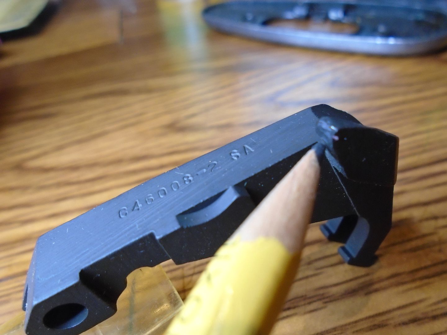

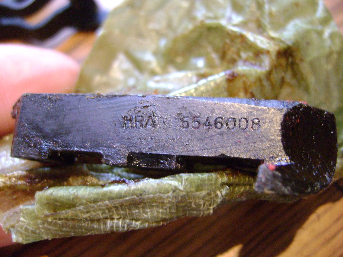

Trigger guard called NOS, notice the flat spots on bottom of lugs

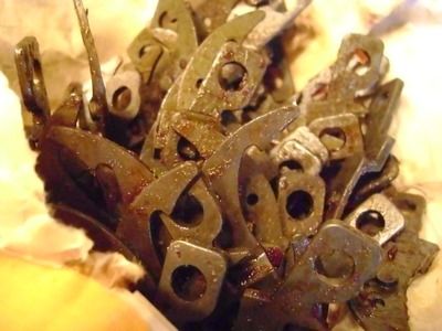

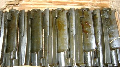

These are NOS

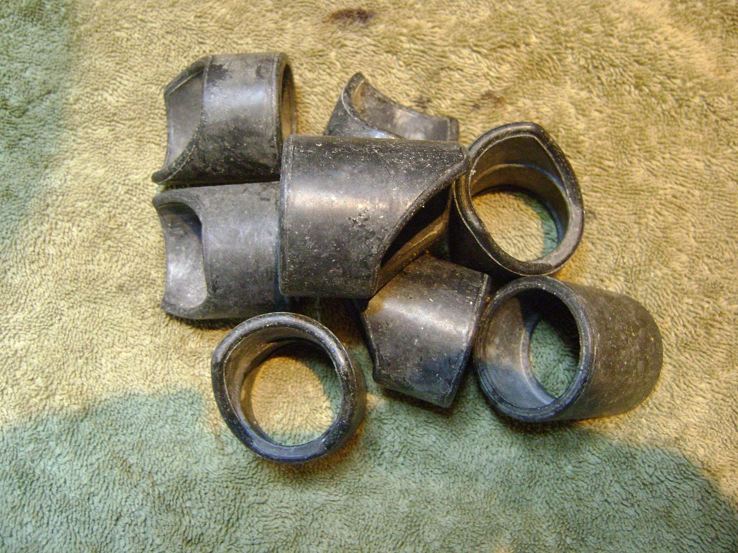

These are NOS

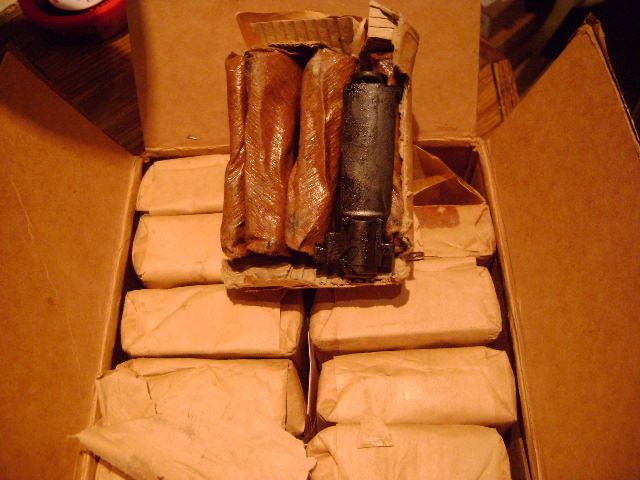

Original finish gas screws the bottom will be shiny no finish
