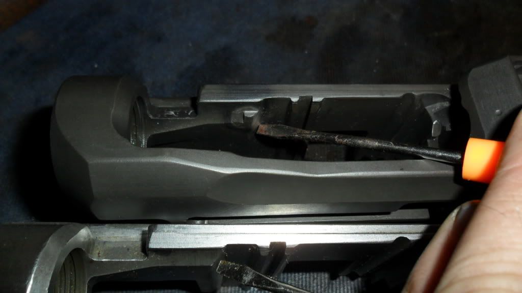

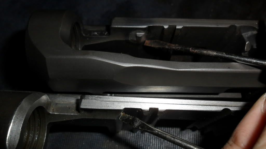

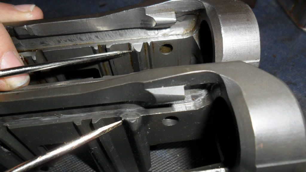

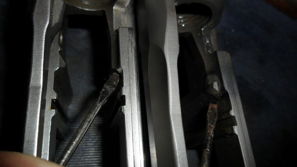

Seventh Round Mod. Explained in Pics
    Don't forget the "extra wide rib" receivers, about a dozen known to date, most had the correction. Serials
    run from the late 30K to early 43K
      You're right, we need to post some pics of the wide and the extra narrow rib variations too.
        Please forgive the newbie question, but what is this "7th round mod" and what does it do? I see some subtle differences but don't understand what the purpose is.
        ​m14brian
          Some early rifles had the boring of the barrel bore drilled too deeply which resulted in the 7th round being less than fully supported as it was hit by the bolt. Sometimes it would jam when the cartridge zigged where it should have zagged. It was caught early and most of them were fixed in the arsenals.
          Has me wondering if it isn't kind of like the upside down plane on the postage stamp. Most of those were caught and "fixed" making those that did end up in circulation much more valuable.
          Just another variation of Garands that will be pushed out of my price range.
            A few early Winchester receivers were also found like this too. It is also something that is very difficult to fake
              This is the kind of stuff you don't think about when you're my age. I was born 18 years after the rifle was placed into service and all I've ever seen is an extremely reliable auto loader. However it's obvious there were growing pains.
