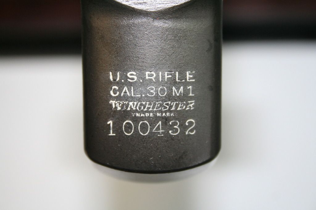

    The photos embedded in this post were taken by me on March 6th, 2015 when I had the chance to photo document three consecutively serial numbered educational order Winchesters. It's my understanding that they've since been refinished in what would be period-correct DuLite finish, which is the same finish that Winchester used back in 1941 and beyond. I have several hundred photos of these rifles and the parts that made them up at the time of transfer to the current owner. Feel free to ask me any questions that you may have about them.

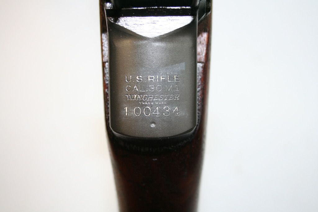

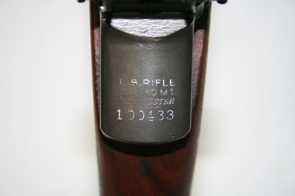

                  Very cool. Here's a few more photos of the heel stamps in case anyone cares.
                  These photos were taken by me on February 19th, 2015. See attached. Not sure if I ever sent these to you.
                  Looking forward to you posting pictures of them in their current state when you get time. I heard they got drooled all over at the GCA convention. Two people called me after they saw them down there.
                    Did you notice the large dimple on 100434 ? I'm not sure what that is but I have seen it on a lot of Winchester receivers either on the heel or the ledge in front of the rear sight right behind the bolt . Several other early and Educational Winchesters have this mark .

                        Also note how small the ' trade mark ' lettering is . Early Winchesters have this feature and the lettering is enlarged later on .
