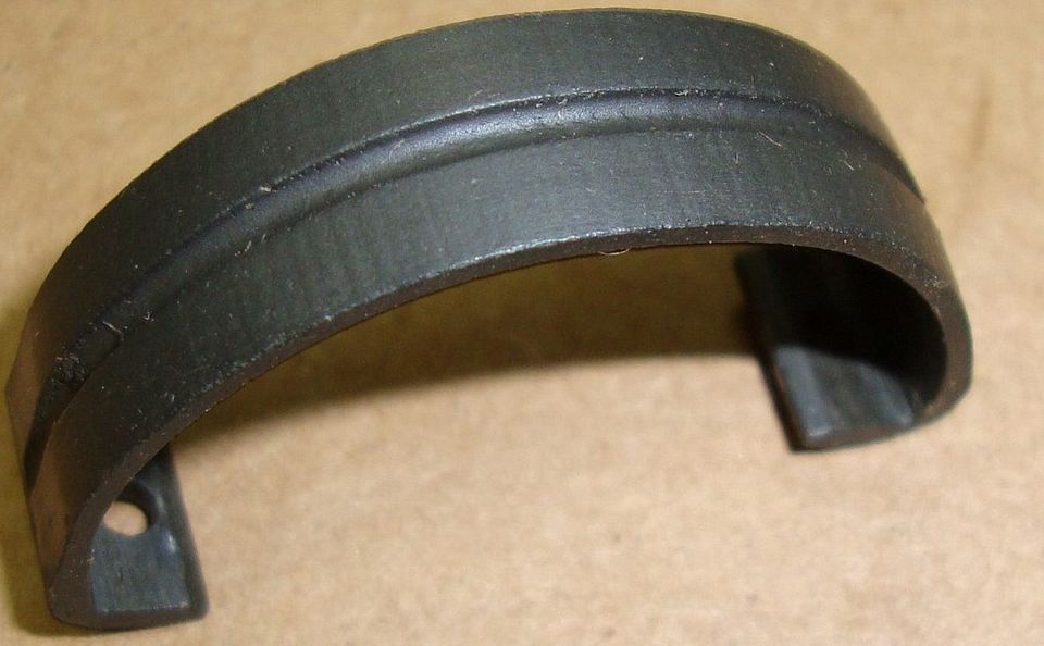

    Purchased a handguard with Grooved Rear Handguard Clip and Grooved Lower Band. I took the Clip off to inspect the underside as I noticed rough machining marks on it. There is the Winchester punch mark!😃I'm getting good at this!

    I wouldnt go by punch mark alone, SA also punch marked parts
    There should be milling lines on the top of the clip

      Sorry mate that's what I meant by machining marks.could send you an email with pics if that's OK.
      Scott
        the machining/milling marks should be topside , straight milling lines

          Yes mate it's very similar!
