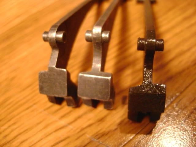

    Does anyone have pics of AN SA unmarked single bevel follower Arm?
    I am looking for one for my SA 200442 but am unsure where to find one and what exactly they l99k like and how they differ from WRA single bevel.
    Thank you!

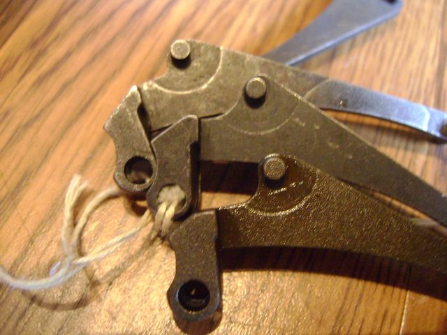

    The SA single bevel follower arm was out of the system by the mid 40K serial range. What you need is the flat face follower arm for your 200442 rifle.
    My photo shows one on the right side, Orlando has better photos as there was a double face than flat face from mid 1940 into early 1941 Click image for larger version

      I.am guessing these are very hard to find?
      Thank you!
      Scott
        from the lefy, flat faced, double face/bevel, late follower. Flat faced aren't that hard to find, double bevels you don't see that often
